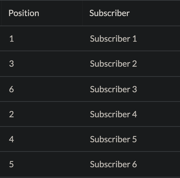

So I was able to generate 1-6 random - non-repeating numbers through a 2-step (2 column) process that was pretty easy.
In Column B1, I input the formula (=UNIQUE(RANDBETWEEN(1,6)).   I dragged that down to row B150 to ensure that all numbers 1-6 would show up at least once.   Then In Column A1, I input the formula (=UNIQUE(B1:B)).  This produces the numbers 1-6 in Column A in the random order they appear in Column B.
