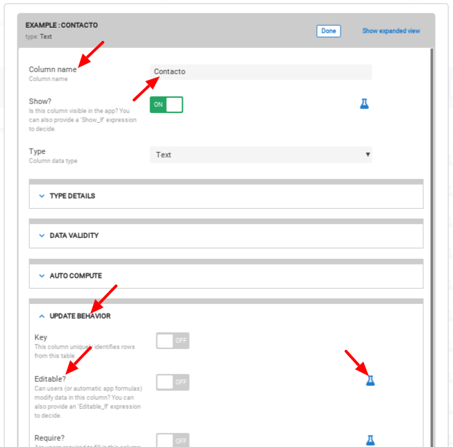

The problem appears to be that the Contacto, Last_Courses, and Last_Payment columns have Editable? set to OFF.
If Editable? is set to OFF, a column value cannot change under any circumstances. In effect, Editable? set to OFF means read-only.

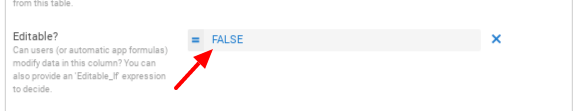

If you just want to prevent the app user from modifying a column value, but want the app itself to modify the value (as appears to be your case), instead set Editable? to the expression, FALSE.

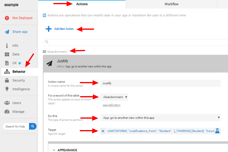

  1. Create a new action for the Abandonment table called (e.g.) Justify.
  2. Set For a record of this table, choose Abandonment.
  3. Set Do this to App: go to another view within this app.
  4. Set Target to the expression:
    LINKTOFORM(
      "Justifications_Form",
      "Abandonment",
        [_THISROW],
      "Student",
        [Student],
      "Course",
        [Course],
      "Month",
        [Month]
    • Replace Justifications_Form with the name of the form view you want used if you dont want to use the system provided form view for the Justifications table.
    • "Abandonment", [_THISROW] sets the value of the Abandonment column of the new Justifications row to a Ref to the Abandonment row that spawned the justification ([_THISROW]). Omit these if you donโ€™t have an Abandonment column in the Justifications table.
    • "Student", [Student] pre-fills the Student column of the new Justifiations row with the value of the Student column of the Abandonment row ([Student]). Course and Month are pre-filled similarly.
  5. Create a new deck, gallery, or table view for the Abandonment table called (e.g.) JustifyAbandonment.
  6. Set the Row Selected event action for the view to the Justify action created above.
  7. Display the new JustifyAbandonment view to the app user to allow them to justify an abandonment by tapping on an abandonment entry.

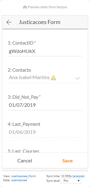

Screenshot:
Current code:
LINKTOFORM(
โ€œJusticacoes_Formโ€,
โ€œContactIDโ€,
[ContactID],
โ€œContactoโ€,
[Contacto],
โ€œDid_Not_Payโ€,
[Did_Not_Pay],
โ€œLast_Coursesโ€,
[Last_All],
โ€œLast_Paymentโ€,
[Last_Payment]
The record created in the google sheet is the following:
columns 1 and 3 were filled in by the code and WERE recorded
columns 2, 4 and 5 were filled in by the code and were NOT recorded
Helpโ€ฆ

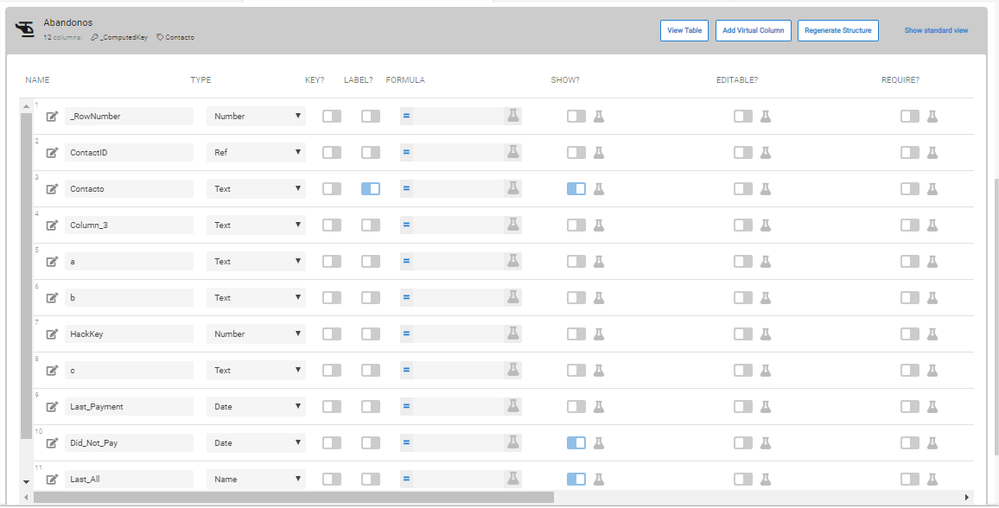

Please post a screenshot of the column list for the table from the Data > Columns tab in the app editor.
Abandonos - 1/2
Abandonos 2/2
Computed key: CONCATENATE([ContactID],": ",[Did_Not_Pay])
Justificacoes
Side note: I tried to make ContactID and Did_Not_Pay as Not Editable but I have not managed to โ€˜convinceโ€™ appsheet to itโ€ฆ
The ContactID and Did_Not_Pay columns have a similar problem: they are effectively read-only (equivalent to Editable? set to OFF) because they are used to compute the rowโ€™s key value.
A rowโ€™s key cannot change once initially set; consequently, any column used to construct the key value also cannot change once initially set.
You will need to find or construct a different row key if you want to modify the ContactID and Did_Not_Pay column values.

The FALSE option is quite hidden and very important!
