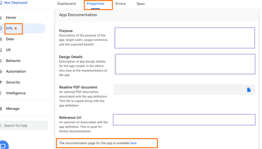

Hi @Joseph_Seddik ,
This is not a direct answer to your question but something that could be useful in such situations. AppSheet gives you ENTIRE documentation ( Starting with tables, slices, and column names and expressions, slice row filter expressions, column expressions etc. So if you are changing a column name , you can beforehand know where it is used if you download AppSheet app documentation at the option below. Once you download,  you can simply search by say a column name, and you will get all instances of that column name , whereever used in the entire app-slice expressions, actions and column app formulas and so on.
This documentation tip was originally shared by @Fabian_Weller  a couple of years ago.

Hi @Joseph_Seddik ,
