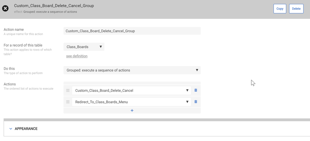

Hi Appsheet fanatic,
When having a button linked to the above grouped Action, the system is able to execute the first action (delete the current record) but the follow action (redirection to another page) is not ran.
Obviously, if I swapped the order, the redirection happens but the record is not deleted.
How could I do that?

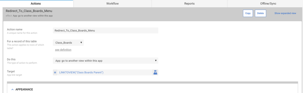

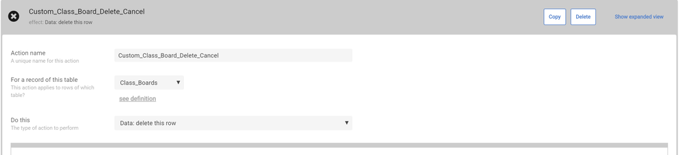

Please provide screenshots of the configurations of the two actions.
Thanks Steve. Here you go.
So the problem, I believe, is that the navigation action doesnโ€™t fire in the second slot because the row that would perform it was deleted by the action in the first slot. Iโ€™m not sure how best to work around this. Perhaps tag the row somehow and use a workflow that triggers on the tag to delete the row?
