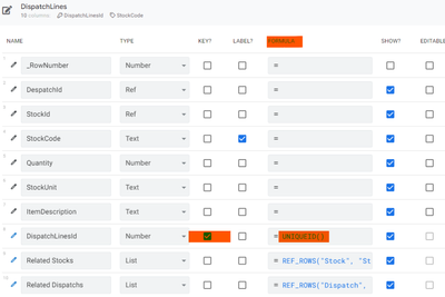

This is not possible.
The key can be either calculated using other real columns, or can be a real column itself.
I think this is the source of your issue.
Moreover, UNIQUEID() must be on INITIAL VALUE column. Otherwise, it is constantly changing and therefore unstable.
I suggest you add this column on your Sheets, click on "regenerate structure" ==> that will turn your virtual column into a real one.
Then, change the location of your expression from FORMULA to INITIAL VALUE.
You may need to artificially create a list of random values to initialize your existing records on this column.

Hi @mbavishi46
This may be due to the fact the key-column is incorrect in your table DispatchLines.
Can you check this?
If you don't have a key-column, I suggest strongly that you add one and set its initial value expression with:
UNIQUEID()

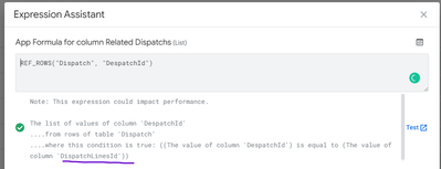

I have added an ID column to the DispatchLines. however, if I set it as the key for the table, then the link between the Dispatch -> DispatchLines breaks.
You would need to adapt the ref_rows expression to catch the id column instead.
I am unsure how to do that. The ID column is a random number so how would I be able to use that to match the other tables? Is there a foreign key to link the two DispatchIDs and StockIDs
The below screenshots are for the DispatchLines Table and the fields that have been added.
The below screenshots are for the other Tables and the fields that have been added.
