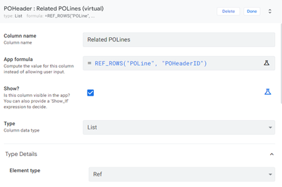

Ref table form not allow to click to open new form
I am make a one app in which PO header and PO Line ,  2 tables are there.
I make ref of PO header and PO line table. But during entry in Form,  ref form is not active.
Please help to make it active.

Not exactly sure what your issue is. Please post some screen shots.

Did you you make it "Is Part Of" ?
Yes, I make it Is part Of?

The only reason I can think of is that the add action of your POline table is set to "Do not display".
I check, add action is active. am I checking correct location
Under Behavior, you should see Add action

I check it seems ok,
Hmmm. Strange
By the way what did you mean by "It is showing Test only but I am not able to click to add PO lines,"?

Actually only Text showing like POR Line (Part Number and quantity). As below yellow highlighted.
It should show New button also for adding line data.
A long shot but try creating a new detail view and see if it makes any difference.
Also do you have another parent - child pair? Do they work?
I have another parent -child parent , it is working fine.  Let me try your suggestion.

A table can only have one Ref column marked IsAPartOf (a row can only be a part of one other row).
I don't know if this has anything to do with your problem but thought I should mention it.
