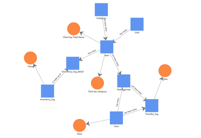

I am currently try to build a simple Appsheet Inventory Management software. Here is the relationship chart:
Premise
I have 3 tables that connected each others, they are:
- item table = id (PK), brand, series, category, unit
- inventory_log table = log_id (PK), dateTime
- inventory_log_details = details_id (PK), inventory_log_id(REF to log_id), item_id(REF to Item), quantity, sn, purchaseDate, warrantyTime

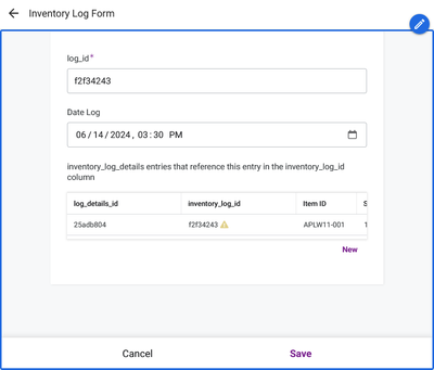

I could successfully make forms uploaded, but they all missing the inventory_log_id (REF) on inventory_log_details result. It shows, but greyed out and warning sign.
Can someone give a solution? thanks
1 3 139
You have this colum (inventory_log_id) as a Ref Type and probably the reference do not exist.
Just edit this row and select a valid reference from the conected table.
it's connected to another table inventory_log, of course it does exist. It even shows up when I do the form, but after form submitted, the warning sign appears. And if check it on Google Sheet Database, it leaves blank.
