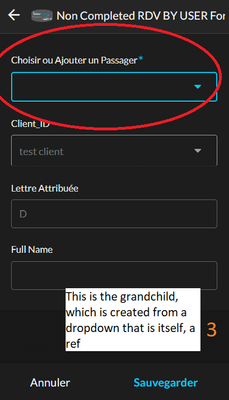

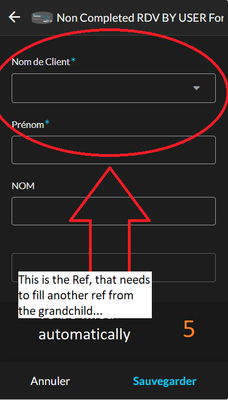

So it might sounds silly, but I'm trying to add info from a parent to a grandchild's reference when we create a new ref For the grandchild... from the child! (I'll add pictures)
The Parent contains a field called [Client ID]
The Child Contains the same [Client ID] as a dereference
The Grandchild also contains the [Client ID] this time as a reference.
Time for photos ! (Edit : I mixed up 2-3, 3 is 2 and 2 is 3)
11
22
33
44
55
So we need to pre-populate the last one (5) with information coming from the child, but only when creating a NEW one from this formview (when it's a grandchild). Keep in mind that this is a REF
I've tried to create a De-Reference to the Parent, name [Ref to parent] then add this formula to the row : [Ref to Parent].[Client ID]
but the result is not the expected Ref-type.
I'm really scratching my head to know if it's even possible... !

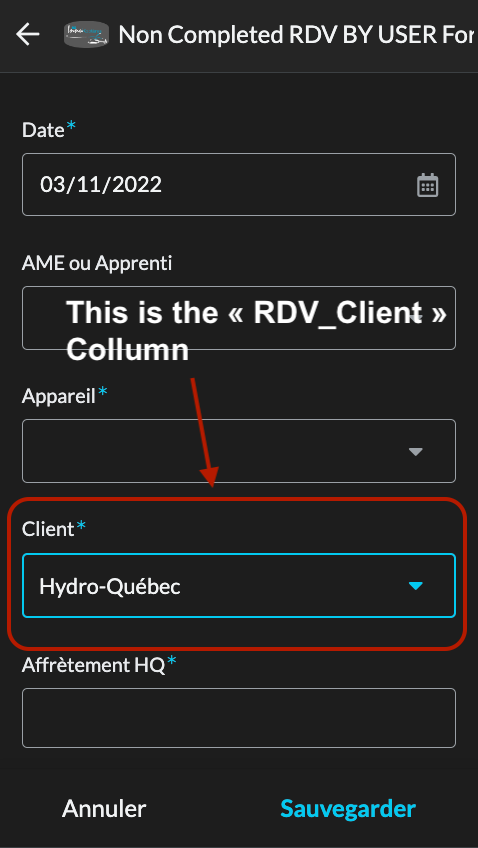

I have a report, in this report there is multiple collumns, the ones that matters are the "RDV_Client" and "RDV_SignataireEmail"
"Rdv_Client" collumn is of the REF type. and refers to a table that contains a list of all the clients, this table contains the key which is "Client_ID"
1- Inside the Form, "RDV_Client"1- Inside the Form, "RDV_Client"
"RDV_SignataireEmail" is an ENUMLIST of the REF Type, and refers to a table that contains a list of all emails that are linked to a specific client, this table also contains the "Client_ID" key has a reference to the clients table
Inside the form "RDV_SignataireEmail"Inside the form "RDV_SignataireEmail"

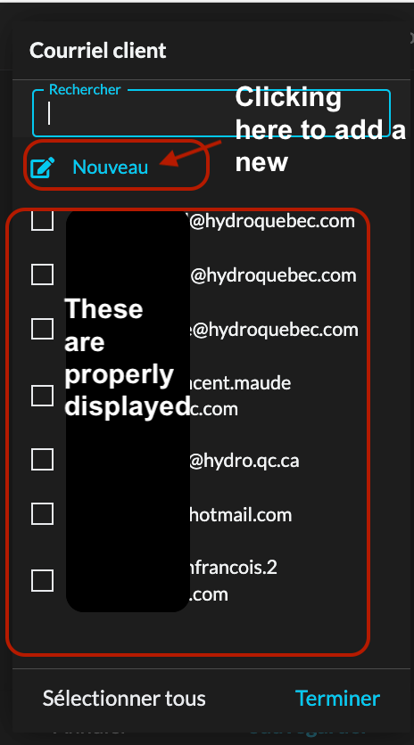

In the use case that I have a new Email to add to this "RDV_SignataireEmail" I want this to have the collumn "Client_ID" prefilled with "RDV_Client"
"RDV_SignataireEmail" EnumList selection, with the option to add a new"RDV_SignataireEmail" EnumList selection, with the option to add a new
I Can easily do that by Checking the "Allow Other Values" and clicking on the "New" at the top of the "EnumList" window, but the Client_ID is NOT prefilled
In the "RDV_SignataireEmail" "NEW", the CLIENT ID is blank, and i don't know how to refer to the "RDV_Client" from here to prefill itIn the "RDV_SignataireEmail" "NEW", the CLIENT ID is blank, and i don't know how to refer to the "RDV_Client" from here to prefill it
