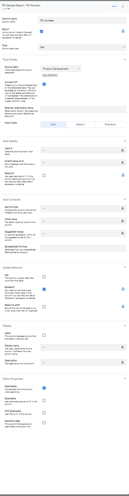

Please post a screenshot of configuration screen for the PD Sample Report column that includes at least the Type Details section. Please also post a screenshot of the entire App formula expression for that column.

this is my reference table / child form PD sample report
this is the column detail for PD Number which is the reference to the main parent form
this is the detail of the reference column in the main parent form.
