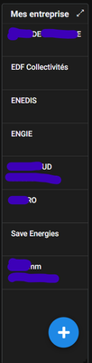

Hi every one,
I'm trying to show a list (ref drop down) of a slice in a form. But in the drop down all the ID's are showing with a yellow sign (error of ref) except for the ones present in the slice (show the name).
The slice work fine when I test it and in views :
I've tried to put an Suggested values expression to solve my issue but it did't help.

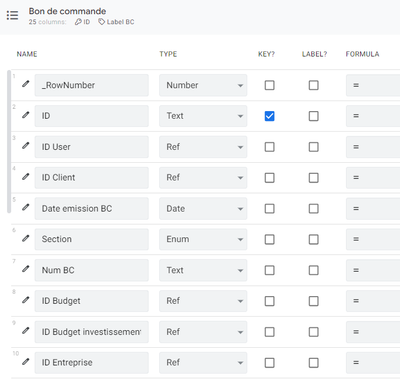

The dropdown from the original post is from this table, column ID Entreprise.
In the column ID Entreprise of the table Bon de commande (the dropdown) the Valid If was :
ORDERBY(Entreprises[ID]; [Nom])
I changed it to :
ORDERBY(Entreprises_User[ID]; [Nom])
Thanks a lot WillowMobileSys

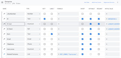

That's my table source :

I can't match up what you have provide with the images in the original post.  In the original post you are showing a column dropdown that has the name of "Enterprise" at the top of the view.
Which column is that?  And what expression do you have in the Valid_If (or Suggested Values) property of THAT column?
