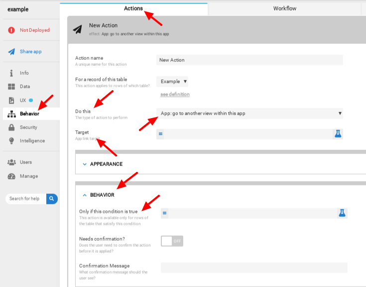

Create an action:
  • Set Do this to App: go to another view within this app.
  • Set Target to an expression that identifies the desired view.
  • Set Only if this condition is true to an expression that evaluates to TRUE when you want the action button displayed. In your case, that might be ("Approved" = [Delivery Schedule]).

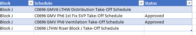

There is also a Delivery Schedules Tbl, this holds all the Schedules by each BLOCK and their Approval Status. Example including only one Block;
Becasue each Block could have the same Schedule, the key of this table is computed by concatenating the Block and Schedule Columns.

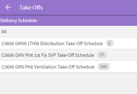

Take Off Blocks
Take Off Delivery Schedules - From Order Details

Manager Approval - Multi Select performed here for each Block Del Schedule (Delivery Schedules Tbl)
Right now, I have a condition on the Make Draw Off Action so that Requests with APPROVED Schedules can make draw offs through the action BUT if two blocks have the same named Schedule then they are both recognised as approved but in reality only Block J Del Schedule may be?
How do I ensure that approving the schedules is specific by BLOCK.
