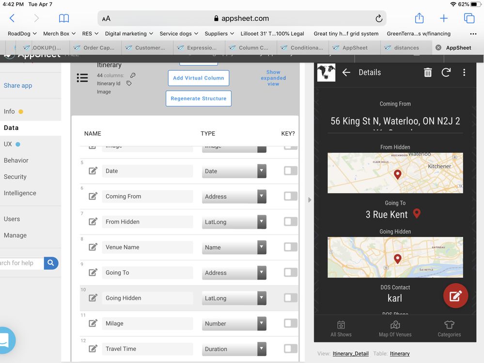

I have an “itinerary” table
I want to be able to enter a “coming from” address and then have the “hidden from” column reference(?) the address in “coming from” and translate it to the approx latlong.
Then I have a “going to” column and a “hidden going” column, that I want to basically do the same, but with a different address.
Then I want to be able to calculate the distance between the 2 as well as calculate the travel time that would take.
  • I think I know how to do this part, at least the distance part and I’ll have to figure out some math to calculate the time…somehow, if that possible.
But I’m stuck because I can’t figure out how the get the latlong columns to pick up on the addresses entered and then calculate the latlong without physically moving the latlong indicator or knowing the latlong of the address.

Unfortunately, at the moment, there is not a direct way to get the LatLong for an address. We hope that this will be changing soon with Google acquiring AppSheet. (A lot of Geo Location functions are most likely changing for the better - fingers crossed)
For now, you have two options:
  1. Manually lookup and enter an approximate LatLong for the address.
  2. Create a Google API call to get the LatLong value. Depending on frequency of calls, this option can result in restrictions or require a paid account. Check into those restrictions first.
Thank you! Great to know before I stress even more!
Just to confirm…
I won’t be able to pick up an address from a latlong OR a latlong from an address? Correct?
As in, even if an address is entered into one field and drops a pin, there’s no way to have another field with a latlong see that pin and translate that into a latlong…right?
That’s correct.
