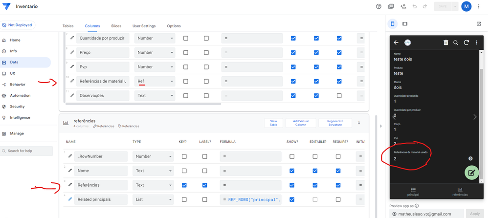

I'm using two tables. One its the main one where I have the autoparts available at my storage and some more details, the second one its a table that only contains the references and materials that I apply to those autoparts.
So imagine that I have a seat injector in table one, and want to reference that i've used the materials x,y,z to repair it, how can I do that? When I reference the second table in the first table, it only allows me to reference the material x.

You will need to use an Enum List with a base type Ref. You may also need to use a Valid if - Table Name[ID]

Hi Austin thanks for the reply, now I have another error, I want to save an ID to be the key of my second table, but it doesnยดt allow me to.
Thank you for the help!
When I try to save the configuration it takes off the key attribute from the ID
It looks like you have 2 key columns selected. You should uncheck the key column - _Rownumber
