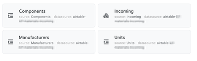

I have 4 tables:
Incoming: where the incoming item is registered when it's received. Refs to Manufacturers and Unit are in place to select  the respective linked records in the tables (in Airtable).
Components: Table that "is part of" Incoming. Basically, they are the components of which an item in Incoming is made of.

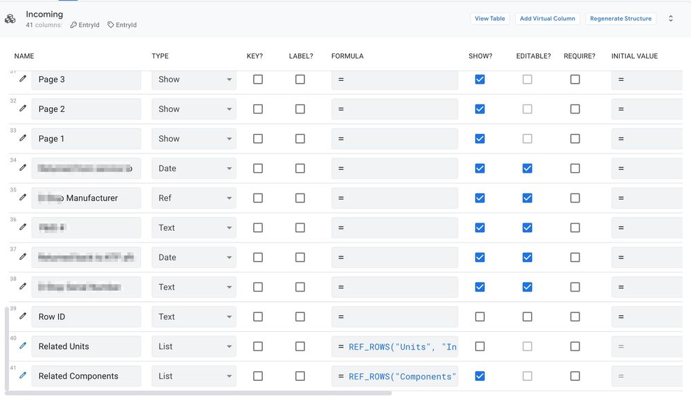

These are the relevant column settings in the "Incoming" table:
Any idea about why AppSheet doesn't see them as linked? Is there anything I'm missing?

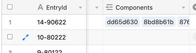

Airtable
Here's a better explanation of the Airtable's screenshots:
The Incoming Table is the one on top. As you can see, the Incoming record with EntryID: 14-90622 has 4 Components records linked to it. The one-to-many relationship between Incoming and Components records is shown in both tables with Incoming having the 4 Components records (their IDs) shown in the Components column and each component record having the "Incoming Link" populated with their "parent" Incoming record ID. Again these relation columns are a core feature of Airtable, nothing special.

The Components table column structure is the following:
It is linked to the Incoming table via the "Incoming Link" column. Here are the column's settings details:
As you can see Components "Is part of" Incoming.

The only missing piece of the puzzle is the Incoming table column structure. There are a lot of columns but the relevant ones are the Refs and the key/label. Here are three screenshots that shows the columns settings of pertinent columns of the Incoming table:
The Refs to Manufactures and Units refer to the two other tables as I mentioned in the original message and are most likely irrelevant in this matter. There's more than one field that refers to the Manufactures table but that is normal and non-problematic.

Did you change anything from the [Related Components] column? Can you share the AppFormula expression?
This may be related to a bug. Do the records appear after a sync?
Hi @SkrOYC ,
Thanks for the reply.
If you mean changed anything in the [Related Components] column settings, I'd say no. Here you have the formula:
REF_ROWS("Components", "Incoming Link")
