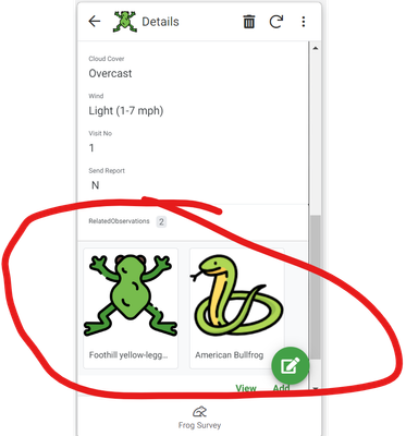

I have an app view with a REF_ROWS showing related records.  The related tables has images and is defaulting to the view to showing the image but I would like to just show an inline table view.  See circled area of image below for what I would like to show as a table view.  Any help would be appreciated.

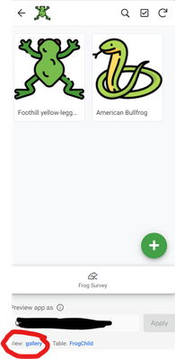

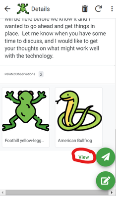

Did note when clicking "View" to see related records,
It takes you to View "gallery"
when clicking on 'gallery" it opens the view settings for the primary navigation view which is a table view and still can see no way to change from image view.
