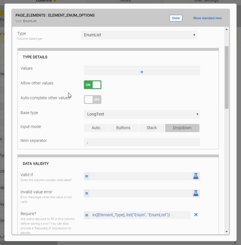

You also have the option of changing the โ€œitem separatorโ€ for enumlists:
This wouldnโ€™t fix the retroactively, but it would from here on out.

I have messed with the Item separator per @MultiTech_Visions post. It works just fine for me to change it to be a comma space, instead of space comma space. New records follow suit just fine.
