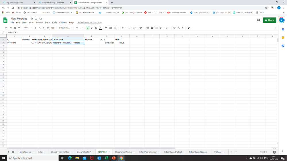

This is my parent table
and then this one is my child table
The QR Codes IDs i get with an enumlist with a ref type
So in QR PRINT table add a virtual column called PRINTLIST
[QR CODES].[QR IMAGE]
the workflow will be on the QR PRINT table
In the template, the images will be in << PRINTLIST >>
