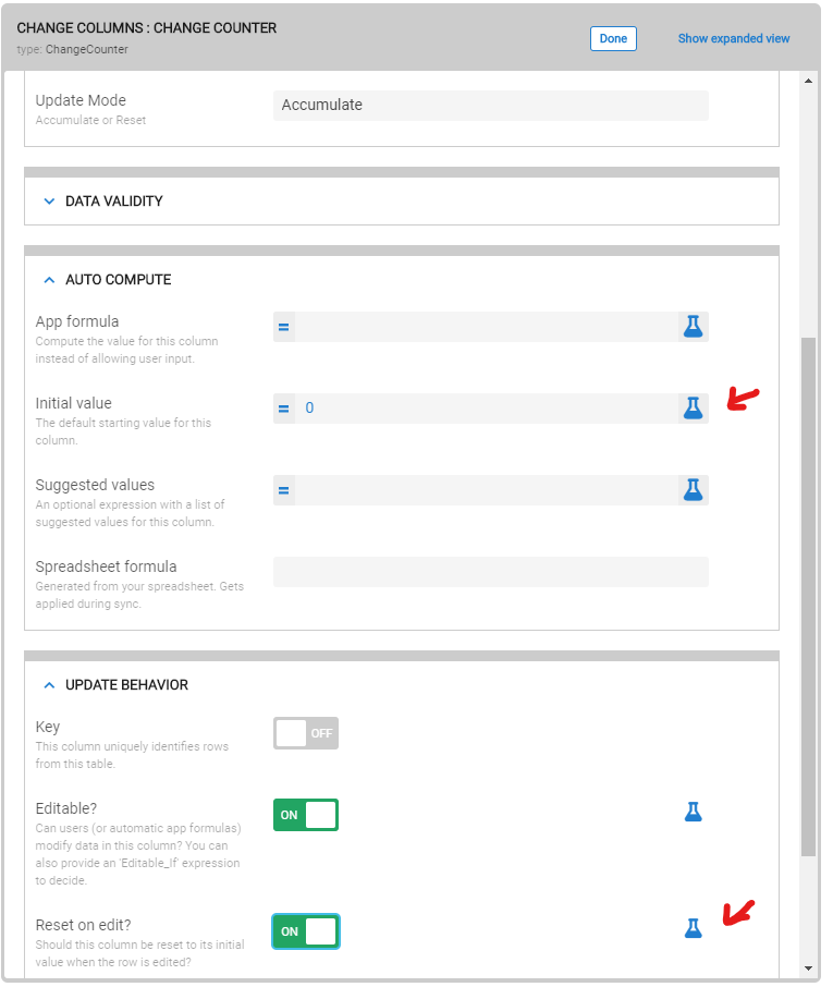

I was trying to do this with the template: SAMPLE APP-Change Columns
For “Change Counter” column made changes as below:
But the Reset field is just switching off and the reset functionality not working. Kindly please help
