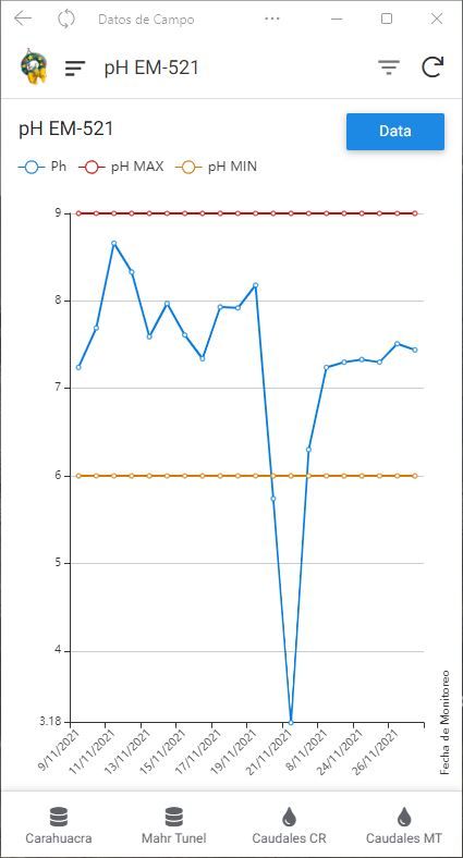

Good morning, I have a table with multiple records, from which I want to retrieve the last N records, these in turn must belong to the same point.
IdReg__|Cod.Punto|pH__|Od|NTU โ€ฆ
2210
|PTO001__|7.45|5.41|12.1
2211
|PTO002
_|8.15|7.97|7.88
2212
|PTO003
_|7.54|6.11|9.12
2213
|PTO001
_|6.78|4.18|7.45
2214
|PTO002
_|8.24|7.91|4.66
2215
|PTO003
_|9.11|7.48|9.44
2216
|PTO001
_|4.47|4.91|8.12
2217
|PTO002
_|6.54|6.88|10.4
2218
|PTO003
_|6.45|5.41|12.4
2219
|PTO001
_|4.47|4.91|8.12
2220
|PTO002
_|6.54|6.88|10.4
2221
|PTO003
_|6.45|_5.41|___12.4
What would be the method to obtain the last 10 records of the table that correspond to โ€œPTO001โ€?
