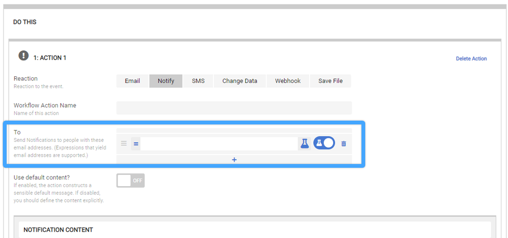

Some version of this formula is what you’re going to need to use in the place to enter emails to send your workflow to:

So to explain, what I want is to write a formula for a notification workflow, for the email address to send the notification to. It sends it when a task is set to Urgent. But it has to send the notification to all the Team members that are responsible for the task.
Basically Send a Notification on a Priority Change of a Task, to all Team members Resopnsible for that Task.

Put something like this in the “To” section of the workflow:
Select(team_members[email], in([Team_Member_ID], [members]))
The idea here is that you’ve got an enumlist that lists the team members for the task (holding the Key ref value for each team member in a list); so in your workflow you can add a formula like what I’ve got above into the “To” section that looks at that list, then pulls all the emails of the people in that list.
