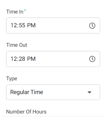

Okay, so I have tried to use this formula to round to the nearest 15 minute interval and for the most part it works. It just doesn't work the way I want when I am trying to get it to round to the next hour. For example if I input 12:55 it doesn't give an output it's just blank. EDIT: However if I change the time to 12:42 it does round to 12:45. It's only the last rounding that isn't working. The last rounding being towards the next full hour.  I must be missing something.

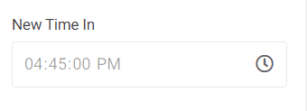

In these attached images [New Time In] is the result of the formula taking values from [Time In]

Some more information,
These are the same columns when the formula does work. "new time in" calculates the "time in" column with this formula
It rounds correctly for every time for example :17, :32, :33 , :34 , :35 etc... up until :52 anything after that :53, :54, :55, :56 , :57 , :58 ,:59 does not work.
