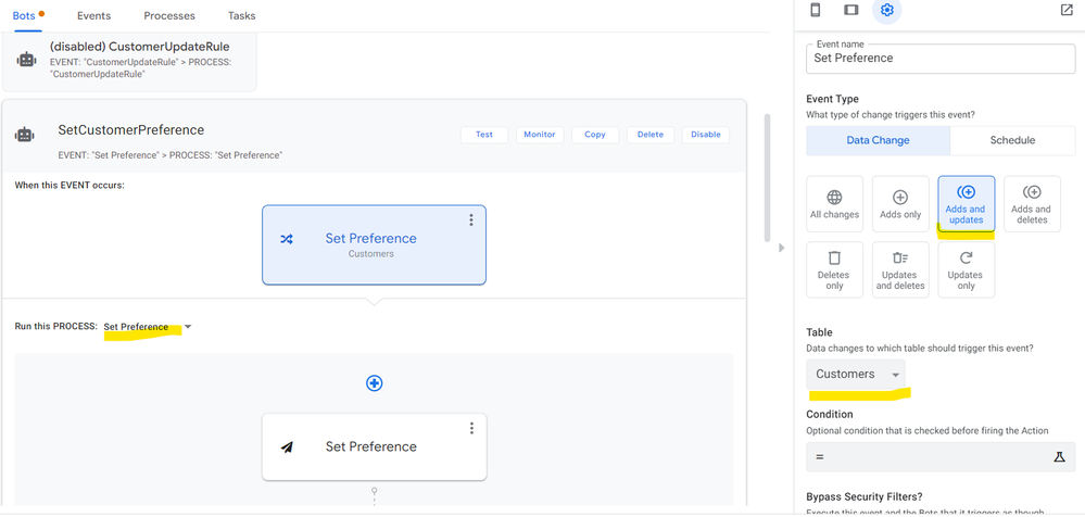

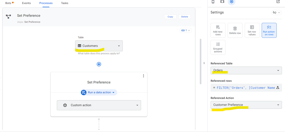

Okay, thank you. As I mentioned, with my testing, bot  worked. Maybe, there is some incorrect understanding of your requirement. However, I am sharing the screenshots of the bot configuration that worked, just in case it helps. The bot increments a column value in the referenced table (Orders) whenever there is a change ( add or updates) in Customers.
Image 1: bot set on Table 1( Customers)
Image 2: process set on Table 1( Customers)
Table 2( Orders)
Image 3: Filter expression for the referenced rows of the table 2( Orders)
Image 4: Action on the referenced table
Image 5: Action increases the column value by 1
