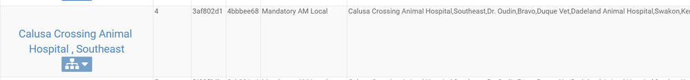

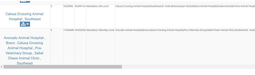

Here is a test of row 4 with TRUE:
Row 4 with โ€œTRUEโ€ quotes:
@Steve not sure I have always found it to cause me issues at times, so I never use quotes with y/n columns
Isnโ€™t this picture just the same results no matter the quotation marks? Maybe Iโ€™m misreading it.
No the results are in the left column. The first one returns 2 items, the second one has zero.
Other columns are blank when the quotes are used and not blank when no quotes are used. I checked in the table and it appears to be producing the correct results.
