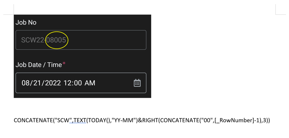

I am having trouble to configure the formula for the Job No. Column..itshould start with SCW then current year - month when the job will be done then followed by the serial number.
The month should follow the job date month...then if the month changes the serial no. should return to 001 but it just continues . Please need advise on the correct formula.

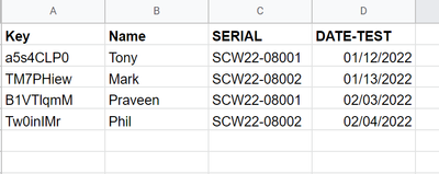

the initial value doesn't change, SCW22-08, since I maintained TODAY() to make it quickly
CONCATENATE("SCW", TEXT(TODAY(), "YY-MM"), IF(MONTH(D4)=IFERROR(MONTH(D3),""), IF(LEN(RIGHT(C3, 3)+1)=3, LEN(RIGHT(C3, 3)+1), IF(LEN(RIGHT(C3, 3)+1)=2, CONCATENATE("0", RIGHT(C3, 3)+1), CONCATENATE("00",RIGHT(C3, 3)+1))), "001"))

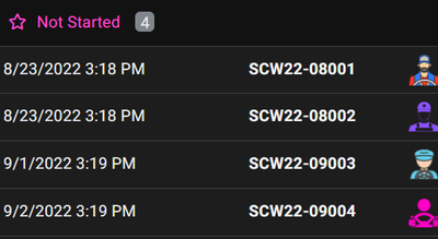

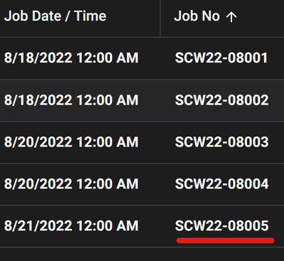

My first photo below is the list of all the Job No for the month of August with the last number ending in 005.
While the 2nd photo is a test...i entered a job for the month of September but the last 3 numbers still continued the serial number from August to 006
The correct job no should be SCW22-09001 since it's a new month
