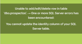

When I add a record, everythings works fine…
But, when I try to update a record, Appsheet send me this error:

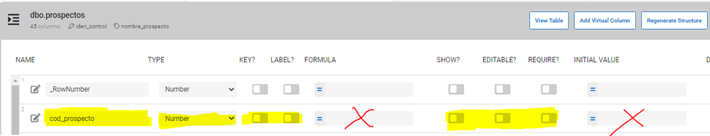

Identity field on Appsheet is set to non updatable nor required, just “show”
UniqueID field is the key to reference everything else.
I don’t understand why Appsheet is trying to edit the identity column when it’s set only to be read, with no formula, no initial value… nothing…

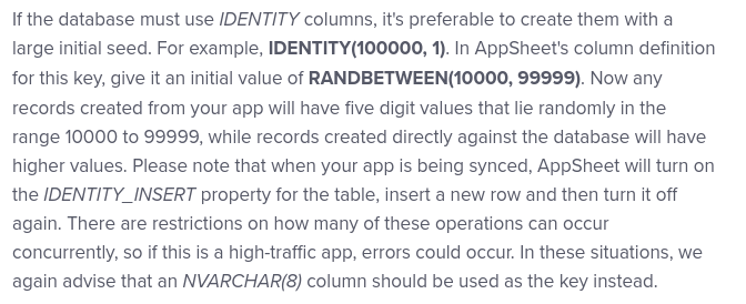

As far as I read, Appsheet can handle 1 by 1 sequential identity column behavior, but for offline usage and multiuser environment suggests (maybe suggestion is the term that I’ve should have use, not recommendation) to change to a nvarchar type field, remove the identity setup or edit the initial seed, etc… Based on the below guidelines:
So, what I did is to create an extra text column to set up as UniqueID on Appsheet. And let my DB handle the real primary key.
What I’ve expected is to use the DB primary identitiy key as reference, and let the extra text column to work as the Appsheet’s primary key in the table.
This is how the column is set on Appsheet:
Just retrieve the value of the column, and that’s it…

I really don’t wanna mess up my structure, and, it’s weird that Appsheet still wants to update something that I set up not to be updated.
Based on the fact that my identity column was set to non updatable on Appsheet, why trying to update that value?
That’s my opinion, but I get the error anyway…
