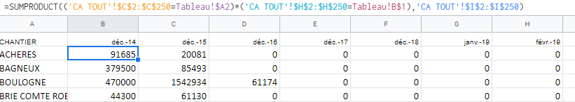

I have two google sheets and sheet 2 is using the SUMPROD function with cells in both sheet 1 and 2.
Appsheet doesn’t seem to be able to get this formula…
Is there any mean to remediate to that issue in APPSHEET ?

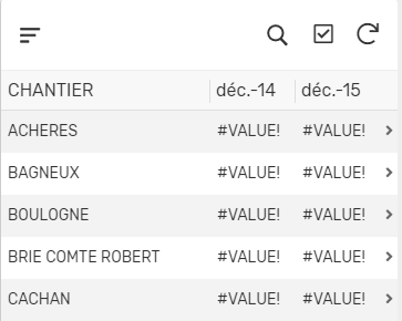

In your spreadsheet, is it only the 0 values that show up in AppSheet as “#VALUE!”? Or is it every value? For example. does AppSheet show the values for dec.-14 and dec.-15 correctly?
I’m wondering if there is some edge case being displayed differently in the two.
Unfortunately it shows “#VALUE” everywhere…
I think appsheet cannot handle the sumprod formula between two sheets.
When I copy the formula into the AppFormula it doesnt not recognize the function.

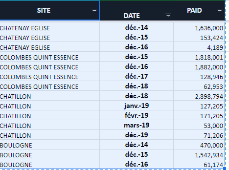

I have a liste of sites for which I am receiving several paiements during the years :

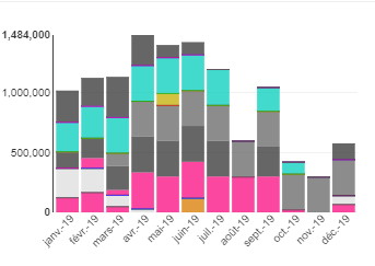

Now, what I want to show is a row serie stack view of this with on the X-axis the month and on the Y-axis the total amount of paiement received during that month like this :
2X_f_f3e995686cd8bfa7c75cb1cb88b31acce3149b11.png Each color corresponds to one site

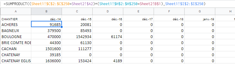

I managed to do so by creating a second sheet with the SUMPRODUCT formula :
The sumproduct formula is taking the value of cell on the first column (here is A4=“BOULOGNE”) and look for all the rows corresponding to that value on the identified column (here column “C” of the other sheet “CA TOUT”). Then it takes the value of the cell of the first row above (here C1=dec-15) and look for the row having that condition on the identified column of the other table (here column H) and then return the sum of the cells of the identified column (here is column I) corresponding the rows having both previous conditions.

Based on my interpretation of the above, I believe an equivalent AppSheet expression would roughly:
SUM(
  SELECT(
    CA TOUT[PAID],
    AND(
      ([_THISROW].[SITE] = [SITE]),
      ([_THISROW].[dec-15] = [DATE])
This sums the PAID column values in the CA TOUT table only from rows where the SITE column value matches the SITE column value of the sumproduct table and the DATE column value matches the dec-15 column value of the sumproduct table.
