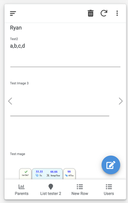

  • a Virtual Column of type Image
  • A Virtual Column of type Show with the Content Type set as Image
Below are the visual results.
The Top line is the Show column.  Notice is has less height BUT has buffer on sides though it will fill the screen the rest of the view.
Bottom line is the Image column.  It seems to carry a minimum height larger than the shown Column.  It does NOT fill the view but instead seems  to have set boundaries to which the view is constrained by.
I am not sure what you goal is but hopefully one of these will work.

My goal with this particular SVG code is to have a dividing line automatically adjustable to the size of the screen. But those generated images has a lot of space above and under it.
SO the Top Line you made is close to what I want to achieve. Still...is there a way to reduce the height even further?
