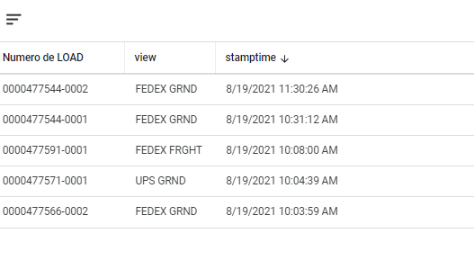

well, I set to work, the first thing I did was create a virtual column and put the formula:
create a new view call โ€œGroupโ€ and in this verify that every pallet that scans show me the information about carrier

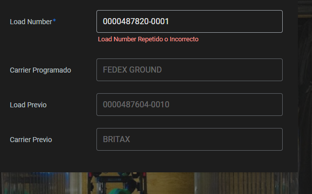

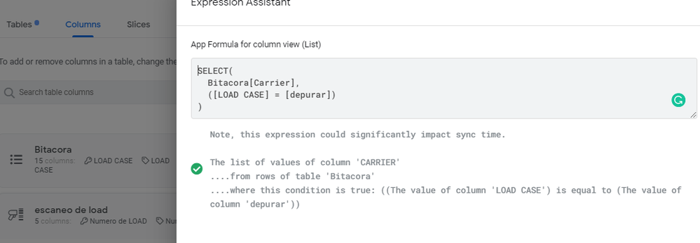

About this finally found a solution.
to verify where must be located each skid I use a virtual column with this formula in initial value:
so when scan this column contains information about the carrier:
also add two more columns where I add the information of the load and carrier number that I just scanned previously, so I can also verify the last thing I scan.
this is the formula that add in Initial value:
in this way the scanning is not slowed down, the only thing I have not been able to achieve is that after scanning I do not have to click on the scanning field againโ€ฆ
