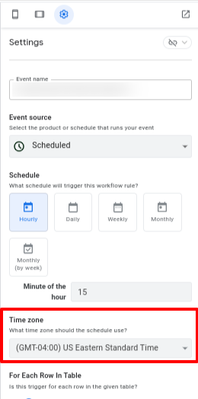

Is the bot event's timezone set properly?
It is set for GMT-7:00 Pacific Standard Time, which is the correct time for Los Angeles.
