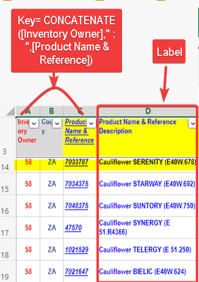

Hi have an issue where a search in a drop down is not finding the label, but search for the key works.
What am I missing? Why do I think the concatenated key is causing the issue?
For example this is the label I am searching for
My label field search tick is on. So can not be that.
Do not find Serenity in search
How I find it if I search for part of the key text.
0 5 264

Maybe this gif helps better explain my situation. Any thoughts

Currently my key is a concatenation of the Inventory Owner and Product Name & Reference columns as shown on picture in my 1st post. This is to ensure that a duplicate product is not created for the same inventory owner.
I have resorted to change my key to just  be my Product Name & Reference alone which is also not a virtual column and it working.
