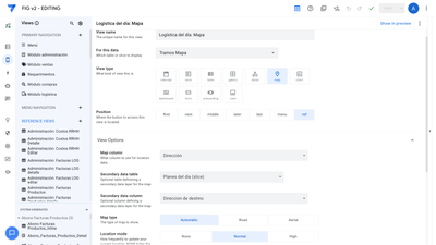

I got it to work if anyone else is wondering. I added a virtual column to table b 'Final point' ([ref A].[Final point]).
In the map view, I set Table B as the data source with 'Pick up point' as the map column, and Table B as the secondary data table with 'Final point' as the secondary data column.

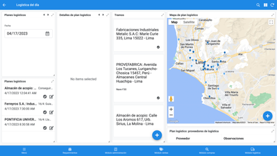

This is what I get when nothing is selected. All points in the database.

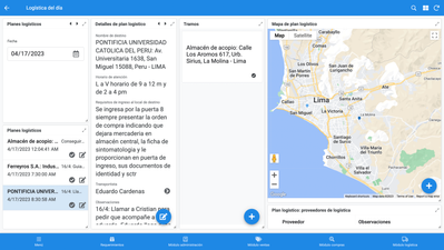

This is what I get when I select a value from table A. 2 pins, start and finish.

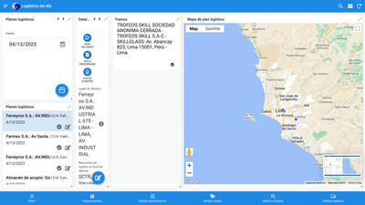

This is what I used to get. Only the starting point pin
