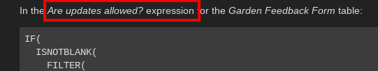

How are form rows added? If from the same app, you’ll need to allow adds, too.
In the Are updates allowed? expression for the Garden Feedback Form table:
IF(
  ISNOTBLANK(
    FILTER(
      "Employees",
      AND(
        (USEREMAIL() = [Useremail]),
        ("Evaluator" = [Oversite])
  "UPDATES_ONLY",
  "READ_ONLY"

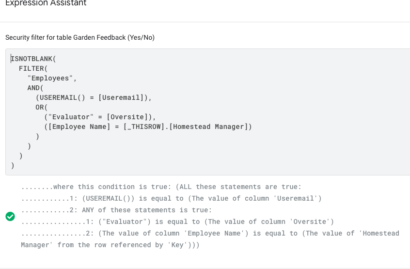

Try this as the security filter expression for the Garden Feedback Form table:
ISNOTBLANK(
  FILTER(
    "Employees",
    AND(
      OR(
        ("Evaluator" = [Oversite]),
        ([Employee Name] = [_THISROW].[Homestead Manager])

Ok I corrected those things, but it’s still not working somehow. I still see all of the entries when I view the app as one of the Employees (not an Evaluator).
I think there may be something wrong with the expression even though it should “work” in app sheet.:
I think the thing that isn’t quite right is the part that says “Evaluator” = [Oversite]. Because that isn’t the case. The [Evaluator] column is the Employee’s name, whereas the [Oversite] column is marked as “Evaluator” or blank. So I think in order to connect the Employee’s name in the [Evaluator] column, it would need to be a de-ref to the [Oversite] column and the text “Evaluator” being TRUE. Does that make sense?
Lmk your thoughts on how that would pan out in an expression. Here is a look at the Employees table so you see what I’m talking about…
Nope, it doesn’t make sense.
In the expression I provided, ("Evaluator" = [Oversite]) is asking whether the Oversite column in a row of the Employee table contains the text value of Evaluator, which aligns with your table structure:
Have you tried the Test button in Expression Assistant?
