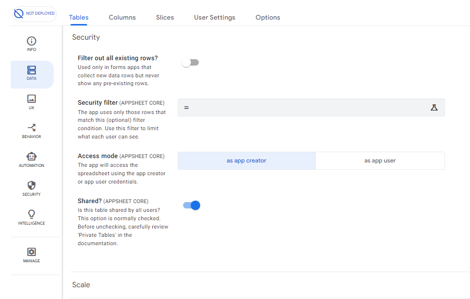

Good afternoon community, I make this query, surely it will also help someone. For me it is uncharted territory. Table security filters.
Although I manage with Slices, what I want is to limit access to the formulas panel to users to prevent the app from breaking.
I saw that there is a part in "tables" called security. When I open that I get Security filter (Appsheet Core).
The question is, how is this? since another security associated with the table appears above (Updates, Adds, Deletes, Read Only)
Is it the same security? How does this change, could someone explain to me that I don't have the slightest idea?

The "another security" is what's called the CRUD permissions (Create, Read, Update, Delete). In all cases the table is visible to and accessible by the user, the only difference is what he can do with it.
The Security Filter on the other hand controls whether a user will have any visibility at all of the table. If the user is not allowed by the Security Filter expression, this table will not even be downloaded on the user's device. As if it just didn't exist.
Ok Joseph, thank you, I still have a question, for example, how is the filter that I should write so that only the administrator has access to the tables and not the common user. I am not referring to the CRUD (create, edit, update and delete) but the part below. I send you an image of the part that I say.
In Security Filter (Appsheet core) that I should to write? Is there an app where I can see the written example?
You can for example use:  USERROLE() = "Admin"

Hi Friend!
This type of answer is not only useful for me, but also for the entire community since it is a detailed answer, where each point of the question has an answer (as is now the case on the networks and on whatsapp) it is very practical . I think this is a little explored and exploited topic.
The last question I have.
Suppose Joseph, that I am not an admin but a user of the app.
The Admin has set the security filter USERROLE()=“Admin” on all tables. I, as a common user, could enter the app and use it normally, that is, could I see the data that I charge from my cell phone (without downloading anything)?
I have been testing below, placing an email from a user to see how he sees the application and I have seen that he can load data into the spreadsheet through the app in all views without problem (which is what I needed). We already know that the chosen security is USERROLE()=“Admin”
Joseph, podría poner yo esta condición de filtrado?
[UserID]=USEREMAIL()
Podría ser algo así también.. cual de las dos te parece mejor?
