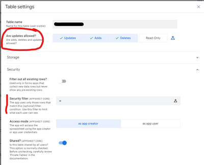

It means your [Email] column's type is not a Ref or Enum (or EnumList) base of Ref. You can only use deref formula if the column type is one of those.
The way I read your question makes me think that you are actually trying to address two separate settings within Appsheet table settings. One is what data do you see, the other is what data can you change. So my question is what are you actually having problems with? I'm going to reach here a little, and say that your "Security Filter" probably works but a user with BSO level can probably still edit data rows even if their email is not in the [Email address] column?
If that is the case then I don't know if Appsheet has a solution yet, as the CRUD 'security' settings are not able to be used at a row level column value according to the documentation. Unless this has changed and I don't know what I'm talking about. If you could clarify what your issue is I think we might be able to help you better understand. See the screenshot below to helpfully point out the differences:
