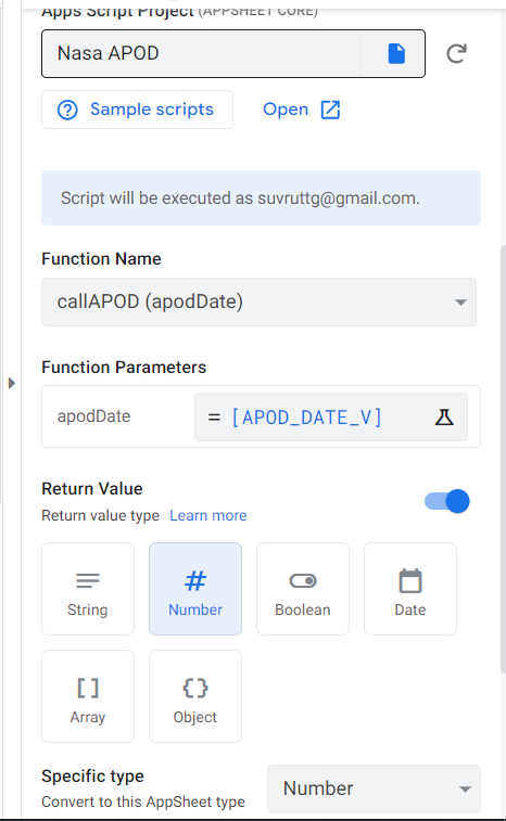

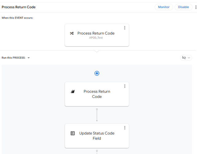

To add to @scott192 's guidance, if you are using Google Apps Script (GAS) , I believe you could try to use the following method for example to get the status code.
Class HTTPResponse  |  Apps Script  |  Google for Developers
The below very simple implementation runs a minor GAS script to fetch the status code from the NASA public API APOD ( Astronomy picture of the day) I could not produce error condition such as giving a wrong date etc. So teh returned code was always 200. But I hope you will get the idea.
The following GIF shows the Status code being populated in the App's card view.
The GAS code is as follows that I called through a "Call a script" automation in AppSheet app.
function callAPOD(apodDate) {
  // The APOD URL
const url = "https://api.nasa.gov/planetary/apod?api_key=API_KEY&date=";
  const endpoint = url+ apodDate
  var response = UrlFetchApp.fetch(endpoint);
  Logger.log(response);
  var responseCode = response.getResponseCode();
  Logger.log("response code: "+responseCode);
    return responseCode
The bot part looks like below
Show More
Overall bot:
GAS calling step:
Return code updating step:
