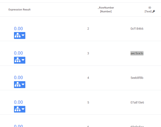

I want to sum the values ​​of the column (ROI) in the table "arbitraje" in another table "summary" IF I use this expression "SUM(SELECT(arbitraje[ROI],[_thisrow].[Crypto]= [Crypto]))" the result is zero, but on the original tables it´s work.
Thanks for your timeimagen_2024-06-13_170943632.pngimagen_2024-06-13_171022351.png

It looks like you have these set up with a reference between the Summary table and the arbitraje table with a reference between Summary[ID] and andarbitraje[cripto]. In this case you should have a REF_ROW column called [Related arbitrajes]. You should be able to use:
  • SUM([Related arbitrajes][ROI])
If that is not the case, it seems like your SELECT() should be
  • SUM(SELECT(arbitraje[ROI],[cripto]=[_thisRow].[ID]))

Thank you for your time, indeed this structure made the data display correctly. I reiterate my thanks, cheers!
