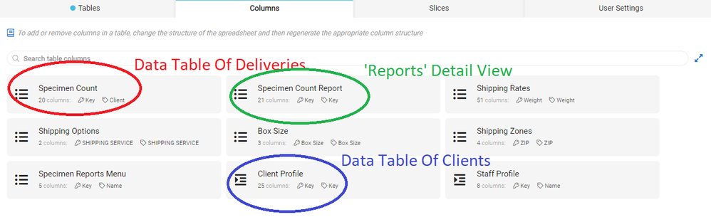

Deliveries Table - Data Table:
[Client] is an Enum of type text, it uses a Valid IF pointing to the Clients table in order to create a dropdown in the form that populates this table.
Reports Table:
[Client] is an Enumlist of type text, it uses a Valid If that points to the Deliveries table in order to create a dropdown in this detail view.

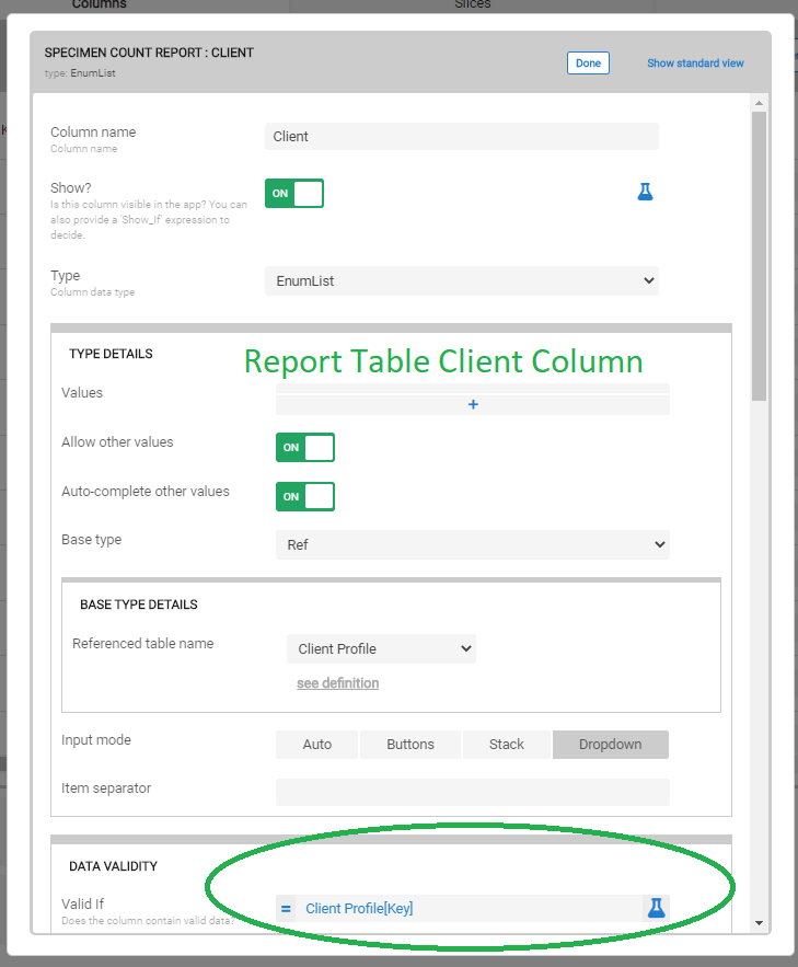

in the reports table i change the [client] column to type Enumlist with base type of Ref and pointed it at the clients table.

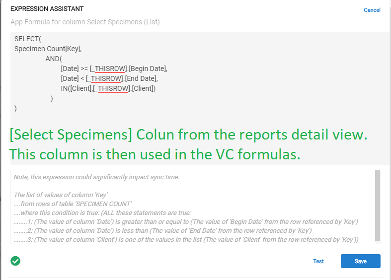

@Seth_Berman, please post a screenshot of the entire expression.

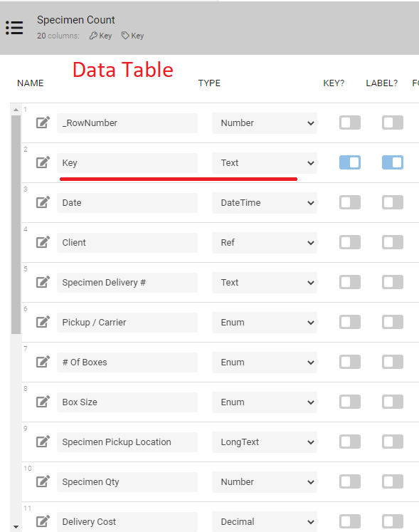

Finally, please post a screenshot of the column list of the Data-Table table that includes ta least the key column.

Select Expression:
Table Layout:

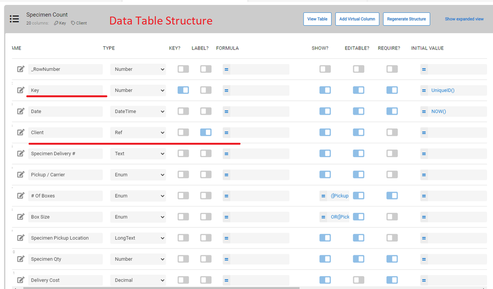

Data Table Structure:

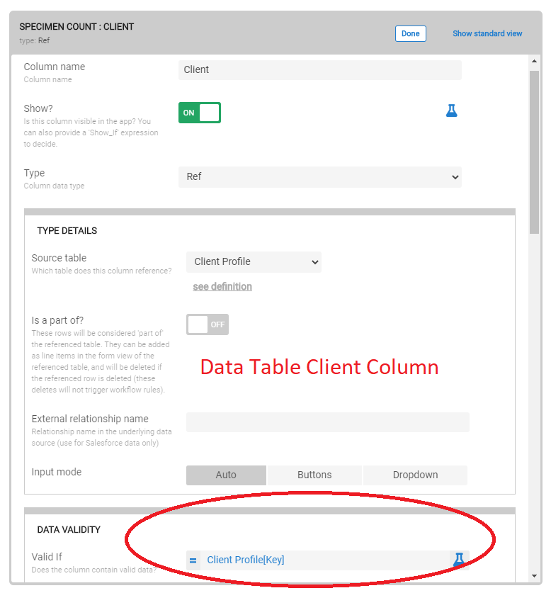

Data Table Client Column:

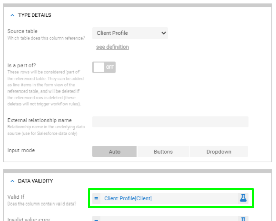

Report Table Client Column:

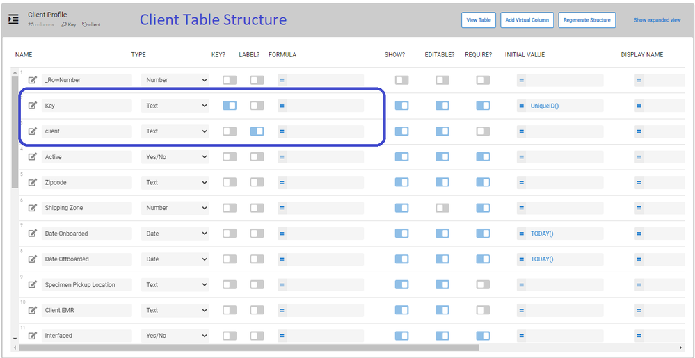

Client Table Client Column:
Column type should be Text:
Valid If should be Client Profile[Key]:
Same here:
Ref values must always be equal to a key column value of the referenced table:

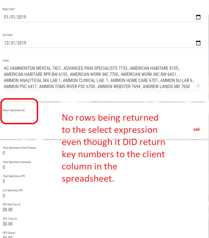

i made those suggested changes and the report view is now returning no data. the client column in the report table is returning a list of keys being selected in the enumlist. i tried changing the label on the client table to client but that did not help.
Screenshot(s), please.
thanks again for all the help.

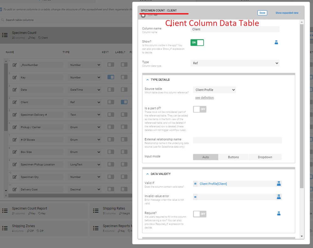

data table columns:
data table client column:
client table columns:

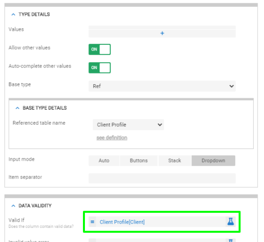

report table client column:
spreadsheet of report table after entering some data:
that same test report in detail view:

not exactly, im not quite getting that far. Specimen Report[Client] gets populated by the user via dropdown and is enumlist / ref with a valid_if to the key of Client Profile[Key]. Client Profile has a column, [Client] that is the label for the table so the user can select from the client names and not the key numbers.
The Specimen Report table uses Specimen Report[Client] in a select expression [Select Specimens] to create a list that a bunch of VCs then use to report on some statistics.

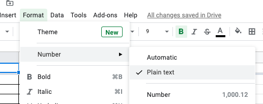

Try removing the apostrophe (directly from the spreadsheet) and sync the app.
If the references start working after that, it’s probably the Google Sheet’s auto-formatting. Change it to ‘Plain Text’.
I’ve had multiple places where google’s auto formatting messed up things in AppSheet. My SOP is to specifically mark each column, in Sheets, as Plain Text if it isn’t used as a number for calculations, etc. This clears up a lot of strange data issues.
that wasn’t the issue here, but i’ve made note to start doing that to all sheet columns rather than leave it on automatic. thanks for the suggestion.
