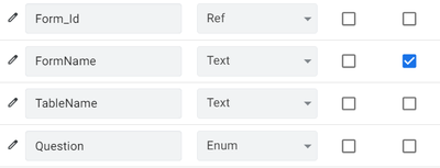

Sure,
I only have two tables.
Question table:
Form Table
Questions [Form Id] is my ref column with forms (id)
I need to bring all the questions from the column Question in Forms where the id selected in the question's form equals the form's id.
For those questions, I need to make sure not to show anything that was already registered in the Question table for the specific form ID.
