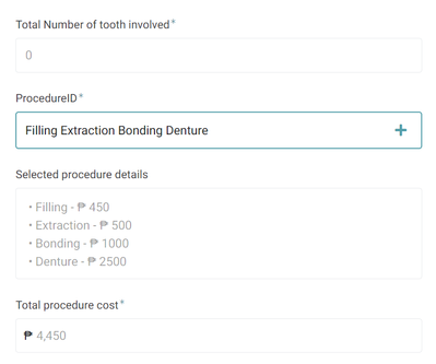

Hello again! 🙂 I want to put this also in my [Total procedure cost] column. If these Procedure Types (Extraction, Filling, Bonding, Denture) are selected in my [ProcedureID] (Enumlist), I want it to be automatically multiplied by my [Procedure Cost] with my number of [Total number of tooth involved]. But my [Total procedure cost] already has this formula = SUM([ProcedureID][Total procedure cost]) where I can sum all the selected [ProcedureID]. I want it to combine if possible. Please help meee.
Note:
My [ProcedureID] is ref from my Procedure Table where my Procedure Type's and Procedure Cost are located. And this is my form...

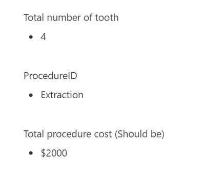

This is the result that I'm aiming
Because extraction is cost $500. So if you multiply it with number of tooth it will be $2000.
But since my [Total procedure cost] had this formula = SUM([ProcedureID][Total procedure cost]) where I can sum all the selected [ProcedureID]. The result I'm aiming for is like this..
Extraction = $500 * 4 = $2000 +$450 which is the cost of filling.

Now, I just wanted to add some expression in my [Total Procedure Cost] column, that if I selected one of this "Bonding", "Extraction", "Denture", "Filling" in my [ProcedureID] (Enum), I want it to automatically multiplied with my [Tooth Involved] * [Procedure Cost]. The rest in my [ProcedureID] will just display its original cost.
this is the result I'm aiming.
