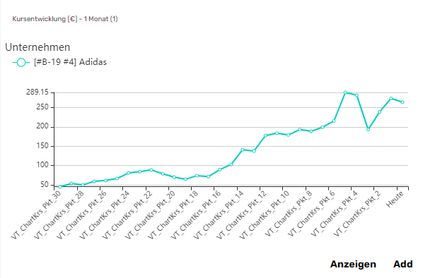

I want to compute a relative value of some absolute value to be shown in a chart. The chart has 30 columns, 1 to 30 point).

I would like have a line chart that shows the historical stock courses.
A: in absolute values
B: in relative values
