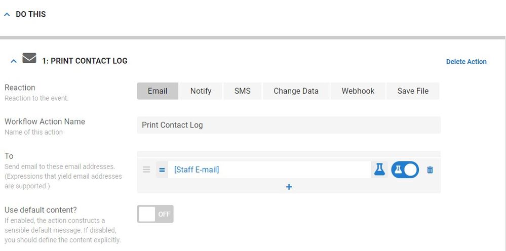

Sure! I work at a school district in Minnesota, and we are using the app to keep track of our process as we assess students for special education. Weโ€™ve been using it since late August and love it! What we need to do is print our contact log. So I have a column labeled โ€œPrint Contact Log?โ€ with a Yes/No button. The next column is an Enum List with the email addresses of our staff.
I then created a Workflow Rule. Under โ€œIf This is Trueโ€ I wrote [Print Contact Log?]=Y. Under โ€œDo This,โ€ I want us to be able to choose which email to send the pdf to. And thatโ€™s where I struggle.
Iโ€™ve got the pdf all set & it works when I put in my own email, but I donโ€™t want all of these pdfs coming to me.
You say you have an EnumList with the email addresses of your staff. Is the user choosing addresses from that list when they also click the Yes button?
Yes, so AppSheet knows who to send the report to.
So you just need to populate To, then. Easy enough! Click the plus to the right of To to add a recipient value, toggle the gray pencil to a blue flask to allow an expression, then enter an expression that produces one or a list of email addresses.
Thatโ€™s where I get stuck! Which expression?
If the name of the EnumList column is Recipients, just use:
[Recipients]
Thank you SO incredibly much for your help with all this. When I write it in . . .
. . . I get this.
Ah. Oops! Try this instead:
CONCATENATE([Staff E-mail])
That works! You are AMAZING! Thank you so much!!
