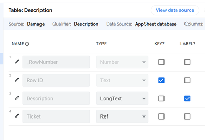

so the photos is added into a seperate table when they are taken with the ticket number as a ref column

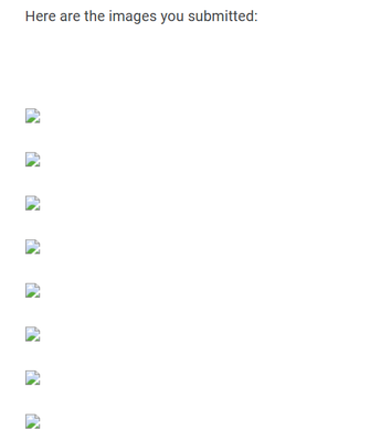

then the ticket table has all the fluff detail in about the ticket i tried using the row ID now and it works but also doesnt XD
the images are not showing up and i did do the while Turn off require image and file URL signing
do you think it might be an issue because the initial table i use is not the main table its because i want it to update when a description is added to this table
