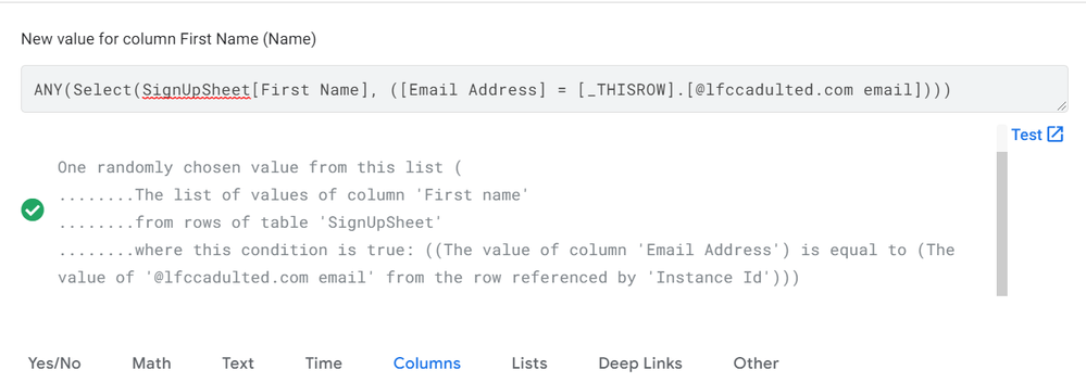

I have a Students1 table, and a SignUpSheet table. I want to create an an action that will set the columns in the Students1 table so they match what is in the SignUpSheet.
Right now, Iโ€™m just trying to pull the names. I tried this for the expression: Any([Related SignUpSheets][First Name]). When I โ€œtestโ€ the action, it shows me the first name of each student, so it should work. But when I run the expression, no data is changed/updated. I also tried using this expression with the same results:

This:
Just means the expression syntax is correct, not that it will produce the desired results. To actually test your expression, use this:

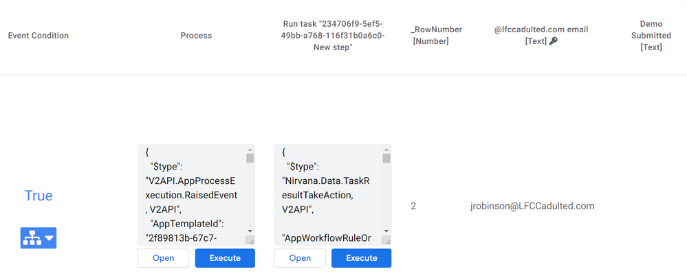

Hi Steve,
Thanks for reaching out. I did use the Test button you mentioned. When I did, it showed me a list of first name values that seemed correct. I didnโ€™t include a screenshot of that, just of the formula that produced it. But now when I run the test, it doesnโ€™t show the first name as it did before. It just tells me the event condition is true:
Not sure why thatโ€™s different now. Iโ€™ll keep messing with it.
