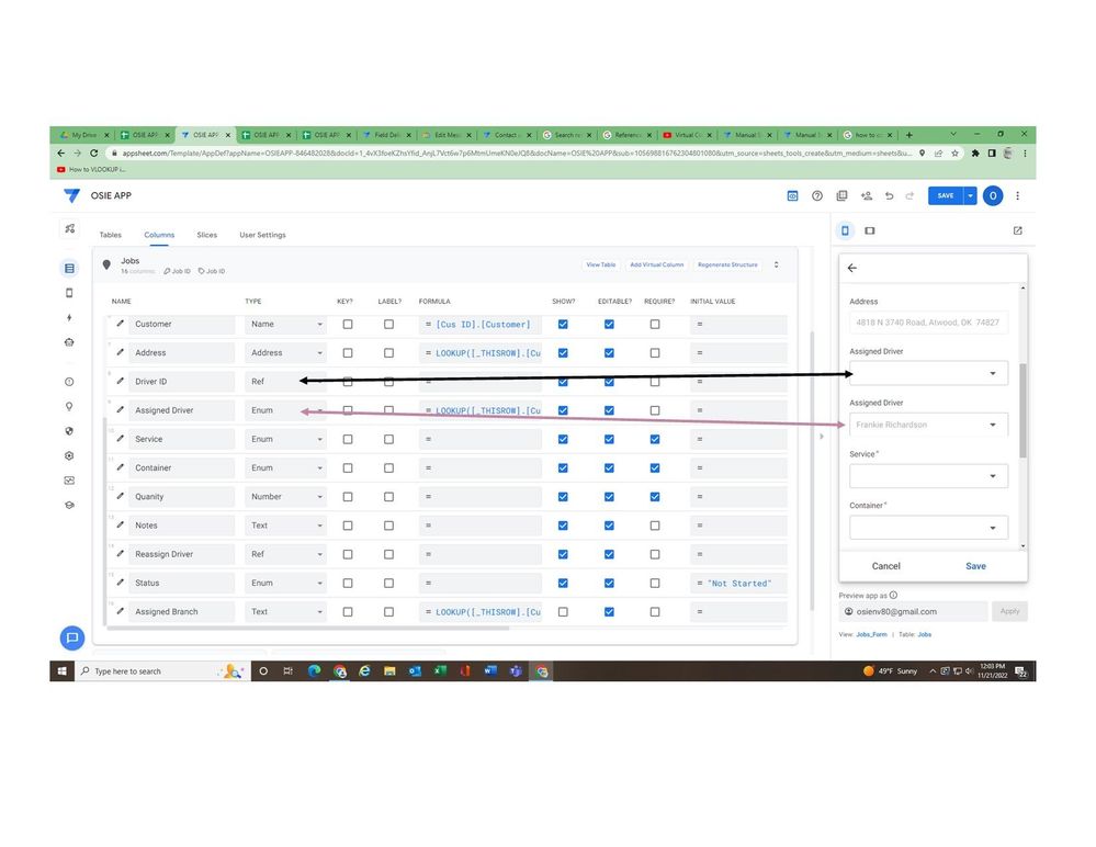

In my app, I want a reference table to default a value from another table and also be editable.
In my "Jobs" table, you can choose a customer from a "Customers" table which has an assigned Driver from the "Team" table.
Each table has a ref column link in the "Jobs" table.
I have tried using ANY(reftable[refcolumn]) formula in "Assigned Driver"; however, it will add the driver into the drop down field again, i.e. not tying to the driver's list of jobs as a related job in a virtual column.
In order to get the job to show up, you have to select the specific driver again from add form.
What I would like is for the assigned driver to default from the customer list but have the ability to reassign a driver for the specific job without overriding the assigned driver in the customers table so that the job will show up in the related job for specific Driver related job in the Team Table.
In screen shots below, the arrows indicate where the data is entered or viewed in relation to the Jobs table.  The "Driver ID" is reference from the "Customers" table and does not auto populate.  In my "Customers" table, "Driver ID" is the key to my "Team" table.  The "Reassign Driver" is referenced to the "Team" table.  I know there is a bit of redundancy.  Again, I am trying to default the driver assigned to the customer and reassigned driver only related to the job.
in your Jobs table, you already have a Ref column to the Customer in the column  named "Cus ID".  You can the dereference pattern for the Assigned Driver column just like you did for the "Customer" column to get the name
In the "Initial Value" property of the "Assigned Driver" column of the Jobs table, use an expression like this:
[Cus ID].[Assigned Driver]
Remove the LOOKUP() function from the "App Formula".  The expression above will set the value from the Customer table as a starting value which a user can then change IF you have set a proper list of possible choices form the column dropdown.
NOTE:  If the [Address] column also comes from the  Customer table, you can use the same "dot" notation idea above to get the Customers address.
