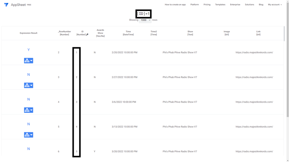

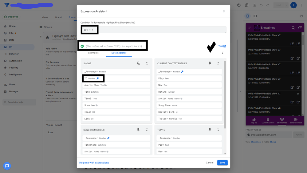

Thank you so much for the reply! Yes, I would think that would work. Some strangeness, I am trying a different approach and just want to highlight the first row of shows. I have setup a format rule where my ID column (key) is = 1. That should be the first row. But when clicking Test Data, it gives me back ALL rows of my data. Why is that? I probably have something incorrectly setup just not sure what it could be.Phis Phab Phive Radio Show - AppSheet - Google Chrome 2_7_2022 6_58_48 AM.png

Here are my $0.02:
I use logic instead of words when it comes to Yes/No. For example, since 0=0 is true, I would use that instead of Yes, True, Y, etc.
Also, since you are trying to use a Yes/No column on your expression, with the column itself is enough. [Awards Show] is already a Yes/No so you don't need to add any other thing.
It seems like you are not doing what @WillowMobileSys said. You have to select wich columns you need to be formated on the Format these columns and actions section.
Your ID is terrible. I'm not blamming you, just change that. Sequential ID's are not a good idea, you should stick to the UNIQUEID() function
https://help.appsheet.com/en/articles/1023086-what-is-a-key
https://help.appsheet.com/en/articles/2357317-uniqueid
Thank you! That was the trick. I just put the ID column in trying to figure out how to get it to work, I won't be using that going forward. The trick was the format these columns and actions, I see that now. Thank you again!!
