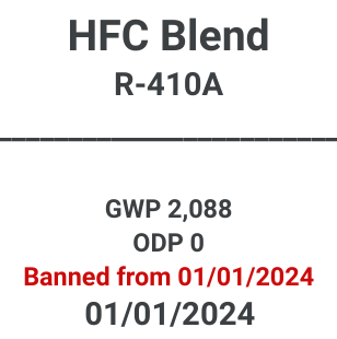

I have a virtual column that concatenates with a column
If that column is empty I do not want to show the virtual column
I use a Show_If statement within the virtual column
However, it shows every time whether the column has data or not

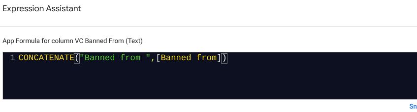

Please post a screenshot of the configuration screen for the column that produces this line:
Hope this is what you want
Steve, the problem is that you concentrate will never be blank as it will always contain โ€œBanned fromโ€. You need to either test for the column to be equal to โ€œBanned fromโ€ or even better change the virtual column to be IF(ISBLANK([Banned From]),"",CONCATENATE("Banned from ",[Banned from])). This will leave the vc blank if [Banned from] is blank and hence will not show.

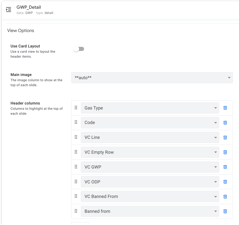

However, I still do not really understand why the Show_If didnโ€™t work.
Surely putting ISNOTBLANK([Banned From]) in the Virtual Column should only show IF [Banned From] contains data!
But thanks anyway!
Show_If does not affect the display of header columns in a detail view. I consider this a bug.
