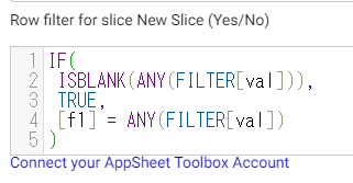

Looks like you need to enclose Dashboard Filter[Carnet Filter] with ANY() so it looks like
IF(
ISBLANK(ANY(Dashboard Filter[Carnet Filter])),
TRUE,
ANY(Dashboard Filter[Carnet Filter]) = [Carnet]

My quick test indicates that the expression is correct.
What happens if you just have
IF(
TRUE,
in your slice filter.

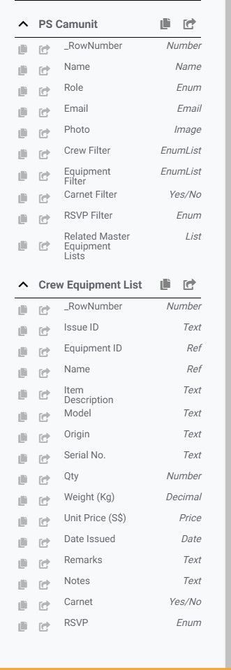

Can you share your schema? I have a similar setup without any problems
Not sure why i'm unable to upload any images
Not sure if this is what you were asking forNot sure if this is what you were asking for
Saezgif.com-gif-maker.gifmple Clip
