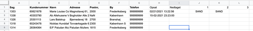

This is how the colums look like
And this is the sheet. If ex. column J (1) has a row with Sand (true) the column should not be shown in the view for another customer.
This customer has the machine marked 1 and is not shown.
But if i view another customer i looks like itโ€™s available.

When marked as Sand it shows Green (Yes). And thatโ€™s ok when i look at that customer
But on this customer (another row) i would like it NOT to show the columns nr. 1 and 2. at all, Since the machines at the first customer.
