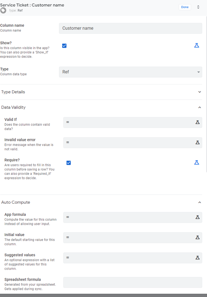

Thanks Suvrutt. I think this should work, but having trouble tweaking. From the Service Ticket table I can still pick the “Not in system” Customer from it’s ref column.
Could you please provide relevant details of how the [Customer Name] column is referenced? I mean expression your are using for this column and other any relevant columns settings for this column.
Hi Suvrutt, here is my customers table:
And here is the referencing Service Ticket customer column setup:
Essentially, I want to be able to see old Service Ticket records referencing the “Not in system” customer row from the Customers table.
But I don’t want the row to show up as an option when I pick a customer name when created a new row in the Service Ticket table.
