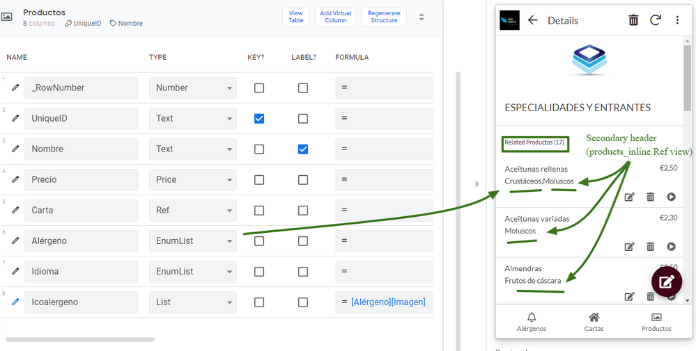

I am developing an application for restaurants. App lists the products and each product has an associated allergen table via Enumlist (Ref name). The allergen table also contains an image field.
I have been looking for a while to display the images instead of the allergen name. I have created a virtual column, to show the image of the enumlist field but it shows the file name and not the image when I assign this virtual field (type list, imageโ€ฆ) as a secondary header in a Ref View.

Just create a slice. Create a new view with that slice. Defer this list column to that slice. You can change your views according to your wish.

I donโ€™t believe you can display images in the secondary header field of a deck view.
On your Alergeno physical column, make sure to pull the ID values from the referenced table and store the value with it.
Then on your VC, set the app formula to get the list of the the rows based on the same enumlist.
It is possible VC is going to display as deck or table or any the list type view, but change the view type over to gallery or any other prefered view you are happy with.
